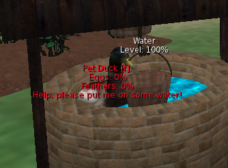

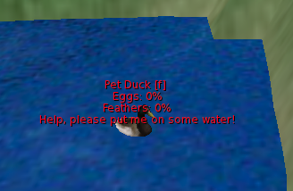

Questão Please tell me... what's wrong with this picture?

Am truly puzzled, here!

If the an_config notecard has SURFACE=water (or water has been set from the Walk on menu item under options) then the animal needs to be on actual water. From your images I think they are on 'prim water' ? To have them work on prim water, set the Walk on option to Flat
